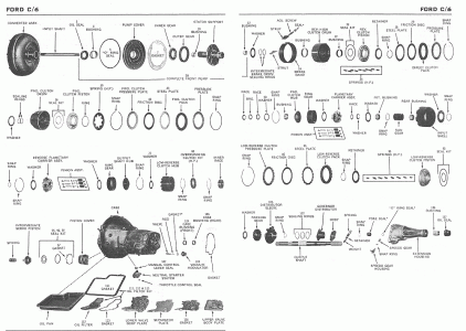

I assume its a C6, if so,
Vacuum Modulator Troubleshooting; You have a modulator on the rear of the transmission. Pull the vacuum line off the modulator. If fluid comes out of the vacuum line,  modulator's diaphram is ruptured, replace modulator. If no fluid, check vacuum in the line with modulator removed, should be around 15 in.  If not, trace line back to intake manifold vacuum tree or vacuum block on firewall.
C6 Parts Break-Out Diagram w/ Vacuum Modulator shown on middle, bottom of diagram.
See attached C6 Troubleshooting:
