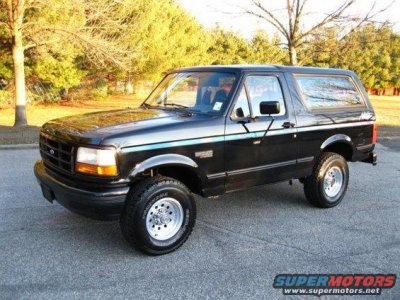

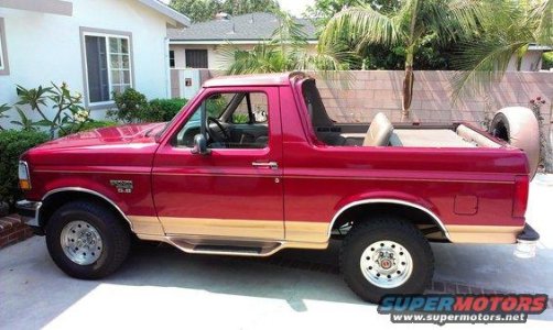

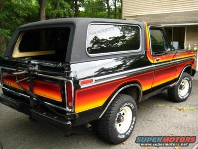

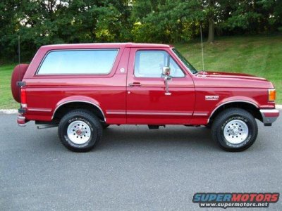

It depends on what your plans are for the Bronco... daily driver (mine) or trail truck.
If you go with the daily diver consider all the nicer optioned trucks like freewheeler, Eddie Bauer, Nite, or SA editions... they're still out there...
