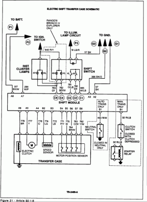

Hi guys im new to this forum and i was hoping someone might be able to help me. I was installing a stereo in my 1989 Ford Bronco 2 xlt and the stereo went in perfect, the problem im having is that there were loose wires in the back of the four wheel drive switch and three of them came out. Now after trying to figure out which ones went where and i put them back in but it still did not work. I was wondering if anyone knows where i might be able to find a diagram that shows the order of the 8 wires because i have been looking online and haven't found any. Any help would be much appreciated. Thanks

Thanks i appreciate the help. Im currently trying to decipher the diagram and trace where the wires go
