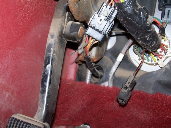

Computer solved the problems!! Was able to drive it to trans shop. A solenoid is not working, having a hard time to shift. Think it may be part of the vss. Speedo not working. Od light is steady burning and is the rear anti lock brake.

Is RABS light lit while driving?
If so;
RABS Self Test & Diagnosis Codes; "...The possible flashout codes are listed and explained in the Flash Codes Chart. Note that Codes 1 and 16 are not used. Flashout Codes Whenever the yellow REAR ABS light comes on during normal operation, a flashout code may be obtained to aid in problem diagnosis. If the vehicle is shut off before the code is read from a RABS-I module, the code will be lost. In some cases, the code may reappear when the vehicle is restarted. In other cases, the vehicle may have to be driven to reproduce the problem and, if the problem was associated with an intermittent condition, it may be difficult to reproduce. Therefore, whenever possible, it is recommended that the code be read before the vehicle is shut off. RABS II modules have been designed with Keep Alive Memory to preserve stored codes during key-off, and are to be used to service all prior year RABS I systems, except for 1987 and 1988 Bronco II vehicles. WARNING: PLACE BLOCKS BEHIND THE REAR WHEELS AND IN FRONT OF THE FRONT WHEELS TO PREVENT THE VEHICLE FROM MOVING WHILE THE FLASHOUT CODE IS BEING TAKEN. NOTE: If the red BRAKE light is also on, due to a grounding of the fluid level circuit (perhaps low brake fluid), no flashout code will be flashed and the REAR ABS light will remain on steadily. NOTE: If there is more than one system fault only the first recognized flashout code may be obtained. Obtaining the Flashout Code A flashout code may be obtained only when the yellow REAR ABS light is on. No code will be flashed if the system is OK. There are certain faults (those associated with the fluid level switch or loss of power to the module) that will cause the system to be deactivated and the REAR ABS light to be illuminated, but will not provide a diagnostic flashout code. Before obtaining the flashout code, drive the vehicle to a level area, and place the shift lever in PARK for automatic transmissions and NEUTRAL for manual transmissions. Notice whether the red BRAKE light is on or not (for future reference) and then apply the parking brake. If a RABS(-1) module is installed, keep the ignition key in the ON position so that the code will not be lost. RABS II modules have been designed with Keep Alive Memory to preserve stored codes during key-off, and are to be used to service all prior year RABS I systems, except for 1987 and 1988 Bronco II vehicles. WARNING: PLACE BLOCKS BEHIND THE REAR WHEELS AND IN FRONT OF THE FRONT WHEELS TO PREVENT THE VEHICLE FROM MOVING WHILE THE FLASHOUT CODE IS BEING TAKEN. To obtain the flashout code, locate the RABS diagnostic connector (with the Bk/Or wire), and attach a jumper wire to it. Momentarily ground it to the chassis. When the ground is made and then broken, the REAR ABS light should begin to flash. NOTE: If the red BRAKE light was on (as noticed before the parking brake was applied), the problem may be with the low fluid level circuit and, in this case, no flashout code will be flashed and the light will remain on steadily. The code consists of a number of short flashes and ends with a long flash. Count the short flashes and include the following long flash in the count to obtain the code number. For example, three short flashes followed by one long flash indicates Flashout Code Four. The code will continue to repeat itself until the key is turned off. It is recommended that the code be verified by reading it several times. In addition, the first code flashed may be too short because it may have been started in the middle. It should be ignored..."
by Stephen @ http://www.supermotors.net/registry/media/280857
RABS Self Test Diagnostic Connector Location pic in a 90; "...It comes out of a large loom under the dash, coming through the firewall, near the parking brake. On mine there are 2 similar connectors in that area, the correct one has only 1 black & orange wire running to it, & was hidden on top of the loom..."
Source: by ElKabong (Ken, El Kabong)
http://www.supermotors.net/getfile/708365/fullsize/100_3187.jpg%20alt=
