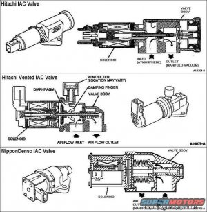

Have you try'd cleaning your Idle Air Control Valve?
It can be found on the left of the intake barrels. I had to do this on my 1989 XLT.

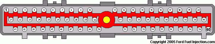

To assist see this EEC IV Connector Pin LEGEND
EEC IV CONNECTOR PIN DIAGRAM

Yo,
OK.  The inability to pull codes leads me to suspect the EEC.
EEC IV Capacitor Repair by seedpress @ http://broncozone.com/topic/20788-fuel-delivery-problem/
Use a 10mm Socket to remove the big Cable bundle connected to the EEC.
Unplug EEC under the hood, drivers side, very low on the fire wall, .
See attached  by Conanski in a 90. Sorry, error message claims that image can't be use.
Should be one small metal ***** holding it. Just slide it out, but be careful with the gasket for the firewall. You can reuse it.
Then remover the kick panel and take it out from inside cab.
