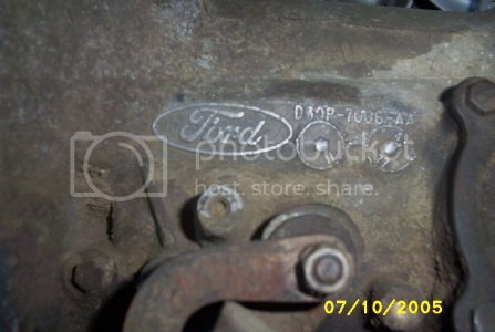

how can i find out the year of my c4 it is not stock but i know it is from a bronco (or the type used) also does any one have a picture of their kick down rod?

how do you know it came from a bronco??? it could of come from a F series with the bronco rear shaft. is it a pan fill?? whats the casting number?? heres the date code. this one is 4-77
