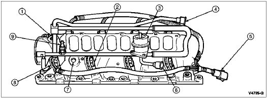

Check the Powertrain Control Module (PCM), sensors and actuators for physical damage; can use these two diagrams to locate ACT, TPS, EVP above EGR),
Ignition Control Module (ICM) on distributor mounted years (Ford re-located the ICM from Distr side to driver side hood hinge area on inner fender liner in 92-96);
http://www.diesel-dave.com/vehic/manual/stj/images/v4795g.gif
1 — ECT Sensor Location
(Part of 9424)
2 9F593 Fuel Injector
3 9C968 Fuel Pressure Regulator
4 9D280 Fuel Injection Supply Manifold
5 9D930 Fuel Charging Wiring
6 — Fuel Return Tube
(Part of 9F792 Assembly)
7 — IAT Sensor Location
(5.8L, 49 States Only)
(Part of 9424)
8 — Water Temperature Sender Location (Part of 9424)
9 — Pressure Relief Valve
(Part of 9F792)
Sensor Locations Diagram ECT, IAT and Water Temperature Gauge Sender; Sensor Locations Diagram ECT & Temp Gauge sender, PCV

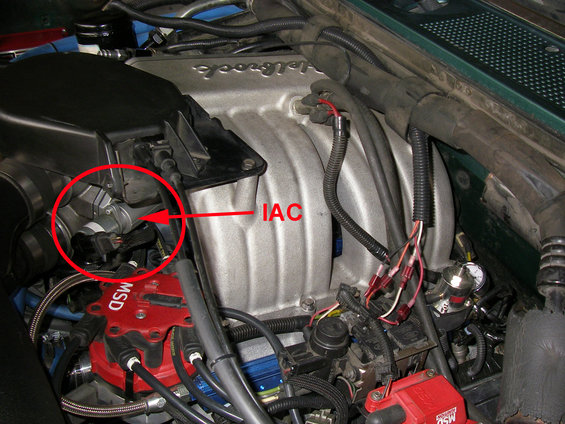

as 68 Merc wrote, Look 2 the (idle Air Control) Solenoid IAC (aka actuator);
IAC Location pic (Driver side of intake manifold under throttle body plastic cover)
