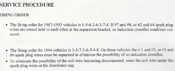

And another guess is the Plug wires
The firing order for 1994- 96 vehicles is 1-3-7-2-6-5-4-8. On these vehicles the #1 and #3, or #5 and #6 spark plug wires must be separated to eliminate the possibility of an induction crossfire. To eliminate the possibility of the coil wire becoming disconnected, route the coil wire under the spark plug wires at the distributor cap. Distributor rotation: Counterclockwise
94-96 5.0 ** - INCLUDES 5.8 - engine miss, spark knock, buck/***** surge and other driveability concerns Source: by Tank92 (Tank) at SuperMotors.net
