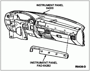

How do you remove the dash skin from a 1992-96 Bronco?
yo F250,
From 96 Bronco-F-Series Workshop Manual (PARTIAL) by dieseldave
http://www.diesel-dave.com/vehic/manual/stj/stjleft.htm
Section 01-12: Instrument Panel and Console
http://www.diesel-dave.com/vehic/manual/stj/stj1c020.htmInstrument
Panel Pad
SPECIAL SERVICE TOOL(S) REQUIRED Description Tool Number Radio Removing Tool T87P-19061-A
FORD RADIO REMOVAL TOOL
can be bought at most Wal Marts and parts stores or use a wire coat hanger and bend it as shown and described in this pdf;
http://www.installdr.com/Graphics/Text/Install-Select-PDF.gif
Removal
  1. Remove radio using Radio Removing Tool T87P-19061-A or equivalent.
  1. Remove glove compartment door finish panel (06036).
  1. Using the radio and glove box door opening, remove the seven nuts retaining instrument panel pad (04282).
  1. Remove the instrument panel pad from vehicle.
Installation
  1. Follow removal procedures in reverse order.

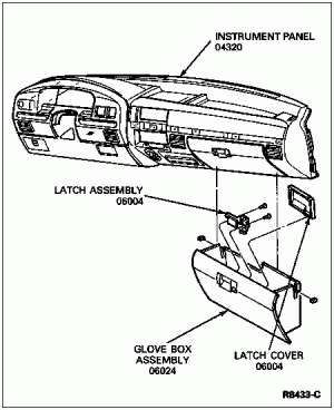

Glove Compartment Removal
http://www.diesel-dave.com/vehic/manual/stj/stj1c025.htm
  1. NOTE: If the door and bin assembly is forcibly removed from the hinges, the keeper feature located on the back side of each hinge is designed to break away without harming normal operation.
    Depress right and left tabs on side of glove compartment door finish panel (06036) and rotate the door and bin assembly until the keeper feature engages, holding the assembly in the open and fully down position.
  1. If necessary to remove the complete door and bin assembly, pull down and out on the door and bin assembly. Wedge and rotate the blade of a flat-head screwdriver between each hinge and tension tab.
  1. Remove assembly.
Installation
  1. Position bottom of door assembly on instrument panel.
  1. Rotate door assembly to a closed position. Right and left tabs should be in the opening stop position.
 Lock, Glove Compartment
Removal
  1. Remove latch cover from inside of glove compartment by unsnapping the four tabs.
  1. Remove the two screws attaching the latch.
  1. Remove the latch.
Installation
  1. Position latch to glove compartment and install two attaching screws.
  1. Install latch cover.

Thanks, but I need to remove the entire dash skin (instrument panel 04320) in the pictures not just the pad or glovebox.
Elmo
Dec 2, 2008
417
Forsyth Georgia
By "remove the skin" do you mean remove  the outer covering from the structure of the dash ? If im not mistaken its all one piece that doesnt come apart. I have seen many dash assemblies removed from these late model Broncos but have never seen one that the outer surface could be replaced except as a whole unit.
F
f2502011
Nov 26, 2011
20
Yes the outer covering.  It does come loose from it's inner structure in these.  I took mine off and one in a junkyard.  In the junkyard I removed the entire unit dash skin and structure as one piece.  Most people say that is easier to remove as a unit, but I didn't think so.  Too many wires involved.
