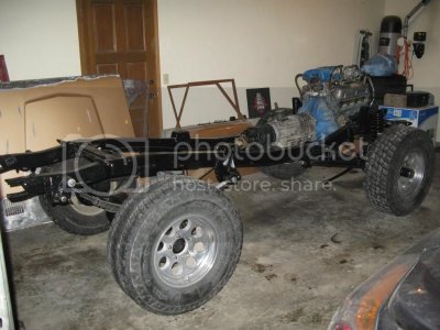

Its relativley cheap to get the frames sandblasted then you can inspect them for cracks, holes and weak spots. If they are good its easy to paint some por-15 or get one powdercoated. I got my frame and front and rear diffs sandblasted for $150 then got them to powdercoat the frame for an extra $450. Now i could have gone to my local parts store and picked up the por-15 for cheaper but i wanted my frame to last. Now keep in mind that was my price up here in Kelowna BC Canada and we pay a serious "sunshine Tax"  on everything just to live in the Okanagan valley.
This is what the rear of my frame looked like when I was restoring my Bronco http://www.supermotors.net/registry/media/855346 .  I used undercoat after treating the metal and then sealed the undercoat to make it tougher.
As mentioned above, powder coat would be the best option.
Just some comments on POR15, I like it and use it.
I didn't use POR15 on my frame because i've had mixed experience with it.   I have had it get chipped and then moisture must have gotten under it.  The result was that I could peal it off in strips where that happened.  It is possible I messed up with the prep prior to using POR15.  It is hard to work with and once you open a can of it you need to use it up or it gets hard, (once exposed to air POR15 starts a curing process that can be sowed by resealing the lid but not stopped).  Also, if you get it on anything you care about, like your cloths, it will not come off. That also goes for your skin,  if you do get it on you, it is on you untill it gradually wears off.  After learning the hard way, I used a full body Tyvec painting suit and gloves when treating a surface with it.
A place that generally seems to rust the most on the frame is around the body mount holes in the frame and brackets.  You can get repair kits that can be welded over the holes that may be in bad shape, (those are available from Jeff's http://broncograveyard.com/bronco?search=%22body+bushings%22 or LMC Truck http://www.lmctruck.com/icatalog/FBR/full.aspx?page=20 .  However, I was not able to find a source for new body mount brackets.  That is not a problem as you can easily fabricate them.
