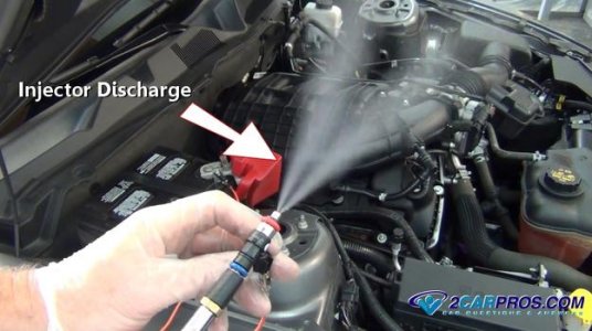

Step 10 - For a final check, remove the injector and attach pressured air to the injector inlet, then use a 12 volt power and ground source to energize the injector, compressed air should be released from the outlet valve. (Note: Traces of fuel will be expelled as well, use typical fire precautions.)
A shorted injector can hinder the injector driver operation for additional injectors, unplug all injectors and re-test pulse trigger, if pulse returns, plug the injectors back in one at a time until the pulse fails, replace the shorted injector. If tests check okay, proceed to next step.
