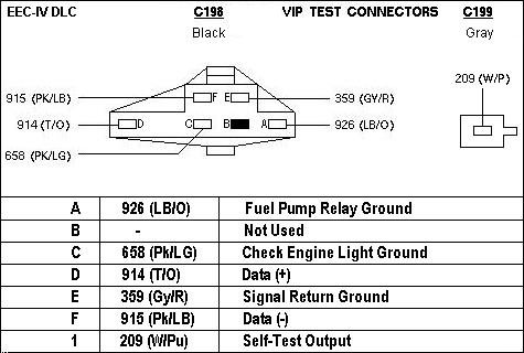

 If the CEL is burned out, connect CEL © to a 12V test light, and the light's other terminal to a 12V source on the same vehicle.
http://www.supermoto...e/dlc-eeciv.jpg
Did you try these tests?  I mentioned it in my first reply;
  see http://troubleshootm...ot-a-no-start-1
The noid light is needed.  Available at local Radio Shack or e bay.
You originally wrote in first post, "Have 40 fuel psi".
but you wrote in your second post, "It will run on starting fluid but no fuel going in to the motor"
How did you measure 40 psi?
Did you turn key to run, then connected FP Relay (terminal A) to any ground (like terminal E) to force the fuel pump(s)?
