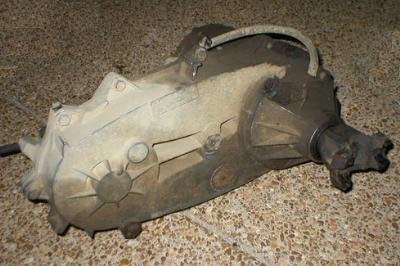

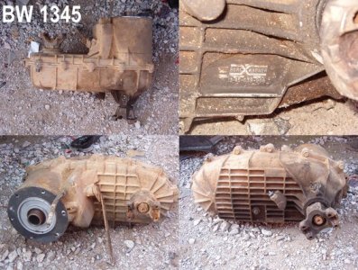

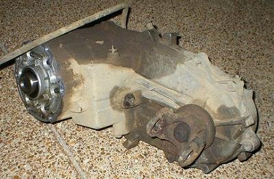

Transfer Cases:
1982-1989 BW1345 31 Spline front input front and rear fixed yokes shift lever is downward parallel to case when in neutral, .875 speedo hole   1980-1986 NP208F 31 Spline front input non-synchronized front & rear fixed yoke
Borg Warner 1345 pics w/ID Location @ http://www.supermoto...ry/media/700792
bw1345.jpg  Note that ALL applications use a fixed rear yoke.
New Process (NP) 208;
208 Overview, Weight, Dimensions, & Image; "...Type: Chain-driven, aluminum; Low-range ratio: 2.61:1 Weight (lb) 79; Lubricant: ATF; Length (in): 8.0 GM); 15.5 (AMC); Width (in.) 20.0; Height (in.) 5.0; Used by: Many full-size vehicles, including Jeep pickups and Wagoneers (which used a left-side front output shaft). A part-time unit that replaced the stronger, heavier NP 203, the NP 208 can't stand up to the horsepower that the NP 205 can, but failure is more often related to low oil level than too much input torque. The 'case utilized left- or right-side front output shafts..."
Source: by 4wheelingplus.com
