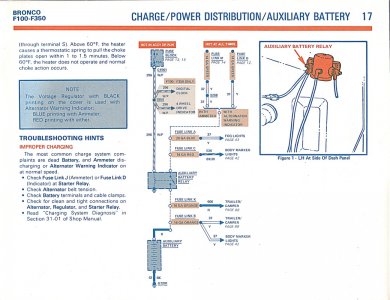

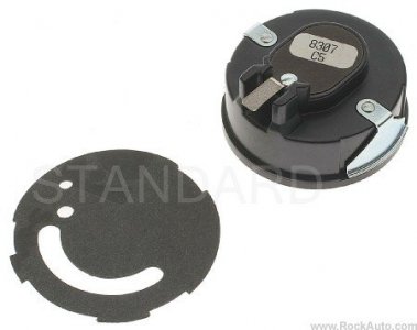

I have a 1982 Ford Bronco with the stock 2 barrel carburetor. It used a heat rise pipe to warm up the choke thermostat. I switched it out for an electric choke. I noticed the S-terminal off the alternator was 7v and some reading told me it was an A/C current. Now with the new electric choke I got it needs a 12v connection. I spliced into the ignition wire which reads 12v when the key is on and attached it to the choke thermostat. When I turn the ignition on, I can feel the choke getting warm. I can turn the choke to open/close the choke for adjusting just fine. But after 15 mins the choke opens but not much. Could this be a bad thermostat out of the box? Also if I take it off and run 12v to it should I see the spring expand? I am in california so the weather has been hot 98-110, when I was working on it the weather was 102 out. Could the thermostat already be open then?
