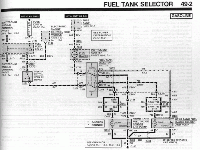

Check voltage @ FP relay & pump
Fuel Pump Relay Wiring Diagram in a 90
Source: by Seattle FSB

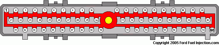

And ÈEC IV Pin Legend @ http://web.archive.org/web/20120118104425/http://www.oldfuelinjection.com/truckpinouts.html
leaving PCM disconnected. Measure resistance between AIRB test pin (PCM PIN 51) and AIRB terminal at wiring harness connector. Measure resistance between AIRD PCM PIN 11) test pin and AIRD terminal at wiring harness connector. If either reading is 5 ohms or more, repair open circuit and repeat QUICK TEST. If both readings are less than 5 ohms, go to step 11).

Can you check the circuit using the wiring diagram?
DTC 96 means a fuel pump secondary circuit failure....secondary circuitis the on/off circuit in the relay that supplies the 12-vdc voltage to the pump and is monitored by the Fuel Pump Monitor (FPM) pin or signal at the ECM pin 19.
