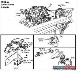

Just want'd to post an up-date on the progress of this issue. Had the turn signal switch replaced and the issue still is there. Mechanic diagnosed the issue to be the cruise servo. Was looking at O'reilly's web site to get a new one buy they don't seem to match my part. Do I need to reuse my own cable or do I need to find a servo with a cable?
Yo Skitter,
I would replace cable if it's damaged.
Following by Ford in 96 Workshop Manual;
"When performing visual inspection, check all items for abnormal conditions. Look for such items as bare, broken or disconnected wires. For the speed control to function properly, speed control actuator cable (9A825) (throttle actuator) and throttle linkage should operate freely and smoothly.
Actuator Cable
  1. Remove cable retaining clip from actuator cable at accelerator cable bracket (9723).
  1. Set throttle plate to closed position.
  1. Pull on the actuator cable to take up any slack. Back off at least one notch so that there is 1mm (0.040 inch) of slack in the cable. The cable must not be pulled tight for proper operation.
  1. While holding the cable, insert the retaining clip and snap securely
