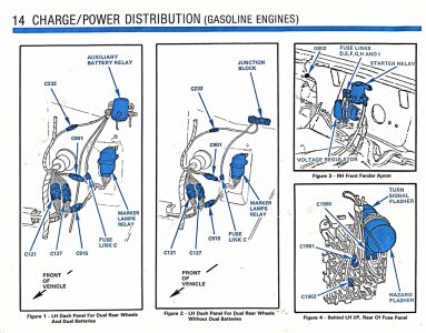

Yo Miesk5,
I'm confused...  Fuse Link C, according to Gary's Garage manual, goes to body marker lamps.  According to All Data, the rear window defroster is actually Fuse Link U - 16 ga orange (wire 186) .  Am I reading the schematic wrong?

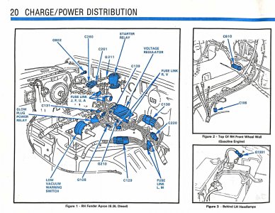

Looks as though this fuse link U is located behind the right headlight, near the starter solenoid in this diagram.  Same location for a Bronco, I assume?
