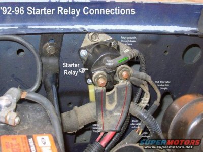

Did you inspect or  replace all  negative cables from battery post to block, to  firewall,  & to intake manifold?
& positive cables to to starter relay and starter?
Edit, is starter relay securely mounted to inner fender rust/grime free area?

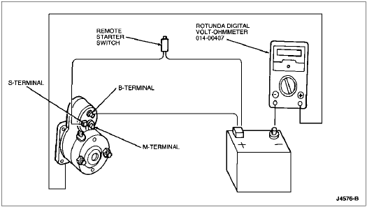

Can you test for voltage at relay and starter?
CAUTION: Make sure transmission is in neutral and parking brake is applied.
Pull the R/LB wire push-on connector at the top of the relay off.  It is marked on diagram as Relay Trigger .
Have a helper turn ignition key to start.
Is there battery voltage (over 12 volts dc) on the red/ligt blue wire?
Diagrams by Mikey350

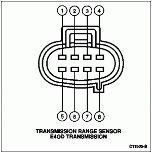

BATTERY FEED TO TRANSMISSION RANGE (TR) SENSOR OR PARK/NEUTRAL POSITION (PNP) SWITCH
Pin Number Circuit Circuit Function:
1 57 (BK) Ground Circuit
2 359 (GY/R) Sensor Signal Return
3 199 (LB/Y) Transmission Range Sensor to PCM
4 463 (R/W) Electronic Transfer Case Module to TR Sensor
5 33 (W/PK) Starter Circuit
6 140 (BK/PK) Backup Lamp
7 298 (P/O) Fused Accessory Feed
8 32 (R/LB) Starter Circuit
With key in START position, check for battery voltage at TR sensor/PNP switch terminal (W/PK). Is voltage present?
  • With key in START position, check for battery voltage at Manual Lever Position/Transmission Range (MLP/TR) Sensor terminal (R/LB).). Is voltage present?
  • With key/push-button switch in start position, check for battery voltage at starter solenoid S terminal (R/BL).
