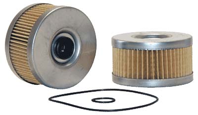

Ford engineering number on the filter is E6TZ-9365-A.
O-ring for the cup is NAPA 3268.
Sone parts stores will mix-up the Ford engineering number
with a part number and give you this when you order E6TZ-9365-A

So, I bought the filter and then replaced it. The reservoir was not leaking anymore, therefore, I test drove the Bronco. It was running great.... Previously, I was getting a lot of hesitation and it went away by replacing filter. Long story short, I parked the truck and checked it again... and now its leaking again. I made sure there were no gaps, but its still leaking. So, I'm assuming, 1. I ruined the ring, 2. I didnt place the ring in the correct place. 3. The reservoir is bad. Where does the O-ring go? I placed it inside the bowl. And used Permatex to keep it in place. But it seems like it's leaking so much more than in the past.
I don't  see the pictures.
I have no idea if the new O Ring is damaged, etc.
Read what Nelbur did.

So, I successful opened the fuel reservoir, come to find out, the O-ring is ruined. I called Autozone, they will have the part ready for pick up this afternoon. Therefore, I'll start off from scratch. The good thing, I have more daylight, because of daylight savings. I took pictures, which I'll upload here in a sec.
