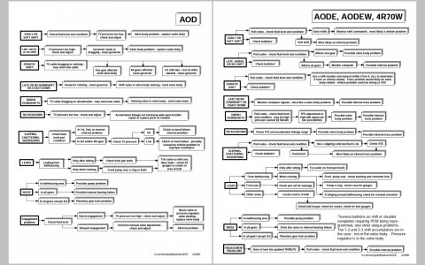

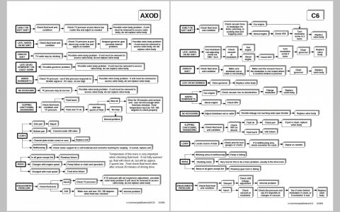

Will try to add more C6 as well as AOD troubleshooting charts in next reply.
