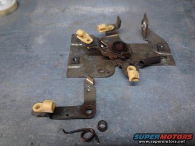

So then the latch control arm just hangs and gets pushed down by the window? Looking at the schematic there and it looks like that literally just hangs there and the window glass hits it on it's way down? Just doesn't seem right

[SIZE=14.4px]Ask at a Ford dealership parts section.  Show them the attached Bronco Graveyard diagram showing a depiction of the clip..[/SIZE]
The tailgate Vertical interlock "rod assembly" guide clip snaps into the "Lower Torsion Bar Bracket" and upper part connects to Control Mechanism, aka Center Mechanism, . It "jams" the inside handle until the glass is all the way down. This bracket is bolted on.
See how BikerPepe` "Also a good time to consider removing the "window down" safety feature...  fixed it by securing the center mechanism
Removing the L bracket and the rod... eliminates the safety feature  If you choose to go that route... you need to be mindful that dropping the tailgate with the window still raised enough to contact the edge of the gate, can easily shatter the glass and potentially cause inury, or at least a considerable mess and major hassle, replacing said glass/defroster/etc. Handle according to your ability, confidence and that of others you may let use your rig.That said... removing the L bracket is easy. I simply took a grinder to the rear of the rivet at the center of the L bracket, on the back side.fsb_tg_lever_adj-(3).jpgOnce you've done that... no need to install the safety catch rod (or a place to put it, for that matter) and you might be able to re-use that same rod keeper, plastic clip... if it's in better shape than one you're keeping in service. If not... I've seen them available somewhere but have no idea to link you.
This is the lever to remove if you want to delete the "window down" safety feature...fsb_tg_lever_adj-(1).jpg
Screenshot_20190805-120313.jpgpassed" it by deleting the "window down" safety feature...
fsb_tg_lever_adj-(1).jpgThis is the lever to remove if you want to delete the "window down" safety feature...
