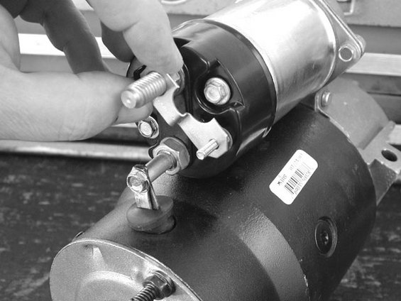

Your new PMGR Starter can run-on for approximately 2 seconds because you may have failed to remove the Bus Bar (seen below) or you jumped the large Starter Solenoid Main Post to the small Solenoid Start Post to eliminate the need for a separate 12v Start Wire. Jumping the Starter Main to the Start Signal on the Starter Solenoid can cause starter run-on after the start switch is off due to the remaining spinning starter motor energy generating mechanical voltage until it completely stops.
When the Starter Relay opens, there is no BATTERY power going to the starter, but the voltage generated by the spinning starter motor is what is keeping the new PMGR Starter Mounted Solenoid from de-energizing quickly to retract the gear from the flywheel.
http://www.supermotors.net/getfile/853552/fullsize/mini-starter-bus-bar.jpg
by Seattle FSB
