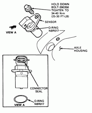

Removal
Disconnect the wiring from the harness.
Remove the sensor hold-down bolt and remove the sensor from the axle.
install:
Thoroughly clean the mounting surfaces. Make sure no dirt falls into the axle. Clean the magnetized sensor pole piece. Metal particles can cause sensor problems. Replace the O-ring.
Coat the new O-ring with clean engine oil.
Position the new sensor on the axle. It should slide into place easily. Correct installation will allow a gap of 0.005-0.045 in. (0.127-1.143mm).
Tighten the hold-down bolt to 25-30 ft. lbs.

Amd by gap, do you mean gap between the sensor and the diff housing? Because the o ring on the aftermarket prevents from
Sitting flush on differential

that oring is a seal and when installed all the way in you will not be able to see the oring at all. it may take some **** and a bit of force to get the vss all the way in. once all the way in the bracket that the bolt goes through should be practically touching the diff housing.
 how about posting a pic of how you have it installed NOW. and a pic of the wires if possible.
