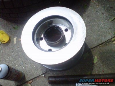

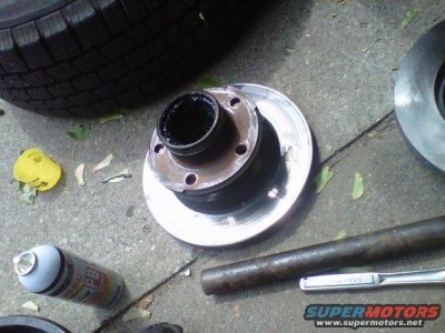

Next step is to remove the hub from the old rotor (it wont be attached no more) and use the old rotor for a base to do the set up.
I put the hub into the old rotor upside down
Then I take the new rotor and lay it onto the hub
Next step is to place the studs back into the holes and take a punch and drive them in just enough to hold the rotor onto the hub. Then I flip the rotor and lay it onto the old rotor. Now, the raised part of the old rotor fits inside the new rotor and will keep the good surface away from being damaged while pressing the studs back in the rest of the way.

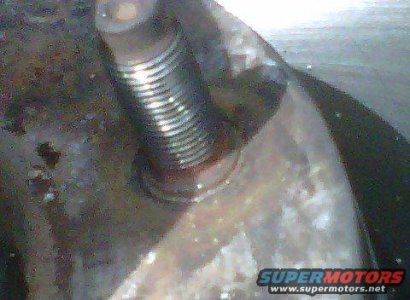

Next you'll need an open lug nut. It can not be a capped lug nut. Tighten it up to pull the stud a little bit through.This will get the stud up enough to have enough threads to grab.
Now, You'll need to come up with a way to pull the studs all the way through so the shoulders are fully through. Using just the lugnut will not allow the shoulders to penetrate all the way through. This is what I use......
1 1/4" socket, 3/4" drive opening to allow the stud to go all the way through the socket. This socket is perfect to do this job.
place the socket onto the stud that already part way through
put the open lug nut inside the socket onto the studI use my impact socket on the lug nut to pull the stud through

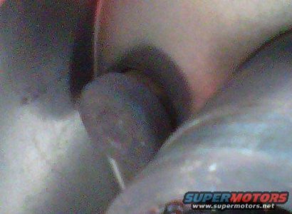

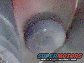

You want the shoulder of the stud to be all the way through like this
Here's what the stud should look like from the backside if fully seated

Here's what it'll look like if you need to keep pressing it through
Once they are all nice and tight, it's time to reinstall the tone ring if you have ABS. Just tap it on being careful not to use too much force.
If it looks like this, keep pressing it through as its not fully seated.." see pic
