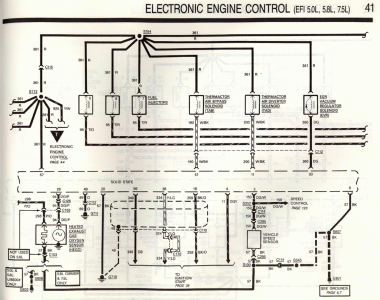

WIRING DIAGRAMS from Ford Electrical and Vacuum Troubleshooting Manual (EVTM) Partial, Bronco, F 150 for 86, 89 & 91
by Ford via Ryan M (Fireguy50) at
http://web.archive.org/web/20130622040914/http://fordfuelinjection.com/?p=36

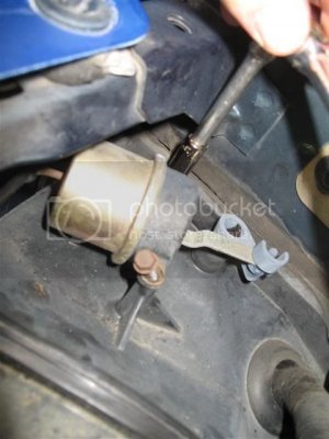

Went with the Bosch o2 sensor and replaced k&N air filter. Motor is tinning much smoother. After all the reolacements I'm still getting codes 41 and 33 during self test. A friend came over and ran a diagnostic test on 500 dollar computer and no codes were showing? Thinking I still have a vacuum line leak. What exactly is the picture below of? Should it be open Or attached to a vacuum line? Thanks again for all your help miesk5. Also below is a pic of old o2 sensor.

Sorry, did not see your pics and post until this morning.
Pic on left is the smog pump's muffler; no vacuum at the muffler.

No, heater lines won't cause a code.  Look on passenger side, firewall/ inner fender liner corner; inspect the Outside Recirculate Air vacuum "motor" & vac line
pic by John M
