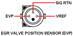

DTC 31 "... This code could be caused by several different factors. If the pintle position sensor (Ford calls it the EVP sensor) is shorted or open, you could have a code set. If the EGR valve becomes carboned up and does not seat fully, the EVP sensor gives a high reading and a code is set. If the diaphragm of the EGR valve is bad, then it, too, is flagged..."
    EVP pic in an 88 5.8; Miesk5 Note EVP is light gray & attached to the top of the EGR Valve
Source: by Travis L
EGR Valve Position sensor (EVP)
This sensor mounted to the Exhaust Gas Recirculation Valve (EGR) monitors its position. The computer delivers less fuel and more spark timing when the EGR is open. Lowering fuel millage and tail pipe emissions.
read more by Ryan M at http://web.archive.org/web/20120121075714/http://www.oldfuelinjection.com/index.php?p=35
Excerpts; "...
Possible causes:
evp.gif•Damaged EVP sensor
•Corroded or dirty connector
•Damaged EGR valve
•Faulty Vacuum system
•Broken wire in harness
•Grounded harness
•Damaged Computer (aka PCM, EEC)

Ford EGR valves will open 100% at 8 inHg of vacuum. Therefore, 50% opening will be obtained by creating 4 inHg, etc.
EGR Valve Position (EVP) Sensor Operation & Testing, Ford
Source: by tomco
http://www.tomco-inc.com/Tech_Tips/ttt19.pdf
TOMCO uses R in test; such as "...While watching the ohmmeter, gradually and steadily apply vacuum to the EGR valve (not exceeding 10 PSI). The ohmmeter should show a steady decrease in the OHM reading. If the ohmmeter needle has any sharp movements or shows a slight increase while applying the vacuum, the sensor is bad. There is also a range that the OHM readings should fall between. In some cases this ranges from no higher than 5,500 OHMs, to no less than 100 OHMs. Check with your service manual for the exact specifications for your vehicle..."
IGNORE all PFE/Or DPFE and look @ EVP info
you'll need a hand op. vac. pump and DVOM; also some long thin straight pins to backprobe harness connectors.
