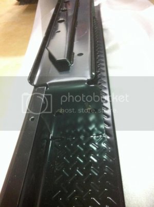

Sorry its taken me a bit to get back.  So the picture were you see 2 holes is the back side of the bumper.  The stock bumper pretty much looks to have the same design but there is a plate that has bolts for the 2 holes then it extends upwards from the bumper and there are 3 holes for bolts that are connected to the Bronco.  The mounting kit is not re usable or i'd just use the parts already present.
So the link below is the part I think I need.
http://www.autopartsnetwork.com/ford-bronco-95600-rear-bumper-mounting-kit-westin/avnZhnAyd46hwiAqIbdZw

You have a clean Forest Service Green Bronco!
Seeing the Bumper now, the Factory kit should work just fine.

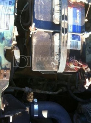

So I went to order the bumper part today and its as much to ship it as to buy it.... I'm heading to napa tomorrow to see if they can do it with out doubling the price.  On another note I seem to have fixed the high RPM issue by cleaning the IAC and replacing the seal.  Also I wanted to see who could tell me what this part is.  its right beside the battery and is basically falling apart.  Its plastic, and looks like the follow: (its right beside the battery, right side)
Here is another pic for a bit more reference:Badpart2.jpg

tiny bump for what the heck is the part beside the battery!
Don't see what you are asking about.  Could you use a program like paint to circe the part?

This might help I tried to leave a little bit of the battery in there as a reference.  The wiring is ok its the rectangular box that you see the top of there.  it appears to have 2 separate sides in the one unit.  Its seems to be all plastic and is basically falling apart.  I have no idea what it does or doesn't do.
OK, that is a carbon canister.  It is part of the vapor emissions system which also equalizes the pressure in the gas tank when your truck sets out in the hot sun.  When you first start the engine it relieves the excess vapor build up.  The system then shuts it off so it won't draw gas through the vapor system.  Hope that makes sense.  In the diagram of a carbed engine below it is the black system at the bottom left. You should be able to see it in your vacuum diagram that is usually located on the radiator frame.

hmmm that sounds important lol.  It hasn't effected the truck as of yet, but as you can see its pretty much gone.  Any thoughts on how hard this is to replace and its effects on the vehicle in its current shape?
It won't show any effect on operation.  Just don't plug the line from the gas tank, as it provides pressure equalization.  That is important when the truck is setting in a hot sun.  it also helps prevent tank collapse when a hot tank cools off.  It is not just for evaporative emissions.
