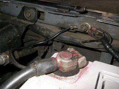

The Scan Tool grounding I posted alleviates a bad Ground ckt from that "Signal Return� Ground" though the EEC and to the grounds at rad support (see pic below)
the EEC (computer) ground comes from two main sources, one is the body/frame ground (G104) and the other is the small black wire that goes directly to the negative terminal of the battery (G101/102). G104 goes to EEC Pin #20 and the TFI ICM. G101/102 goes to EEC Pin #40 & 60. This a direct ground to the battery(-) post and the connection on the radiator support is frequently the cause of problems. It can also corrode developing a poor connection at the negative battery cable connection at the battery post.
