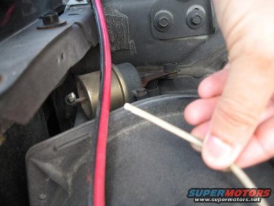

The most common AC vac leak area is at vacuum hose to Outside Recirculate Door Vacuum Motor; on passenger side near firewall and hood hinge
pic by JohnMcD348 at http://i38.photobucket.com/albums/e147/johnmcd348/Bronco%20Vacuum%20Fix/IMG_3429Small.jpg
Ck vacuum supply hose to be sure it is connected to both the engine manifold and the A/C vacuum check valve

Yes, you have a small leak in the vacuum control circuit;
The vac leak could be in a hose that is ruptured or not connected to a device such as Outside Recirculate Door Vacuum Motor; on passenger side near firewall and hood hinge
This is most common leak ara because when hood is open UV rays play havoc on that vacuum hose; and some are damaged while repairs are done on other items.

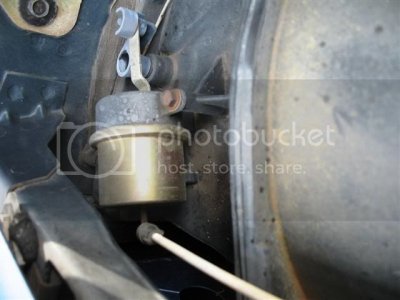

Here it is in another pic
right click on image and open in new window to enlarge pic
pic by Ken showing white vacuum hose is discnnectesd from "Vacuum Motor"
Your white & other HVAC vacuum hose could have been replaced w/black hose by previous owner or shop.

open hood
got to passenger side hood hinge and look into corner where firewall meets fender
see if thevacuum hose is broken, or leaking vacuum, or disconnected from that vacuum motor behind the red and balck hoses.
This is the vacuum motor in a pic by John D

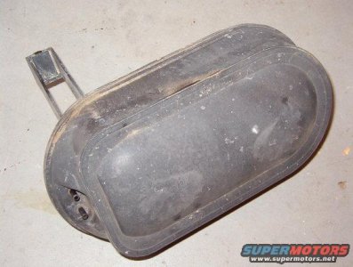

The HVAC Vacuum tank location is inside the engine compartment
Check Valve & Tank Location pic in a 93; "...valve is about a foot down the vacuum line coming off the 'tree' on the engine Plenum. One of the lines on the check valve tee goes to the built-in reservoir on the a/c box, the other into the loom with the white tube heading for the control panel inside ..." by garymunsonhvac Check Valve and Vacuum Reservoir Location pic in a 93 by garymunson.jpg
and diagram by Ford
Another Vacuum Tank is used for Emissions and it is under hood on passenger side between firewall and battery; it is plastic and does not rust as the earlier years' metal coffee can type
