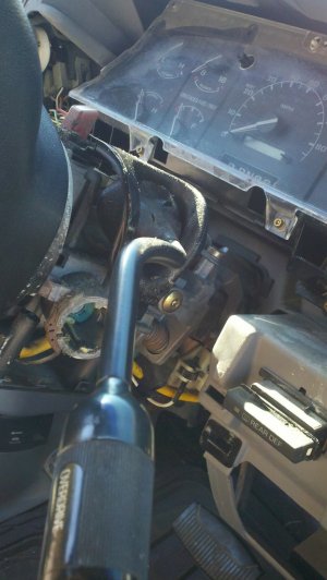

To Just adjust the E4OD Shift Indicator
Star Remove the four screws from the lower steering column shroud. Remove the lower steering column shroud.
2. Rotate transmission range selector lever clockwise until it bottoms out in first gear.
3. Rotate transmission range selector lever counterclockwise three detents (overdrive position).
4. Hang a three pound weight on the transmission range selector lever.
5. Center pointer in the middle of D if equipped with C6 transmission, or (D) if equipped with E4OD transmission, by rotating the thumbwheel located on right-hand side of steering column actuator housing.
Thumbwheel Adjuster Location pic in a 95 5.8; near bottom center of pic, where white tube attaches; Miesk5 Note, Right Click LINK & Open in New Window
