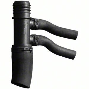

yo Bob,
That is probably the optional oil cooler tubing
In your other post about this, I thought it was the Boss Engine oil cooler adapter, never knew Ford put this type in 5.0 & 5.8 as an option until I went through a brochure (see at end) and this diagram in the Ford EVTM/ Work Shop Manual. see 73 through 77
Here is a replacement hose (6K741)
Here is another description; "...Sarad Part#: KM2923-MOT
Radiator coolant hose. 5.0, lower hose - f5ta-8b273-aac - (if looking for hose directly off water pump with two hoses that go to engine oil cooler, refer to 6k741) (upper)" Price: $23.54 Brand: MotorcraftYears Make Vehicle Engine
1997-1999 Ford F250 Pickup n/a

or;
Sarad Part#: KM2924-MOT
Description:
Radiator coolant hose. 5.8, lower hose - f5ta-8b273-aac - (if looking for hose directly off water pump with two hoses that go to engine oil cooler, refer to 6k741) (upper)
Also ref to as the "ADAPTER, OIL COOLER, ENGINE" in Federal Supply Classification nomenclature.
GOODYEAR, GATES, DAYCO, etc. also makes them.

Wow this is awesome!!!! I had no idea that was an option. Thank you so much now all i got to do is buy that hose take off the cooler and weld a new pipe onto it and i be in business
