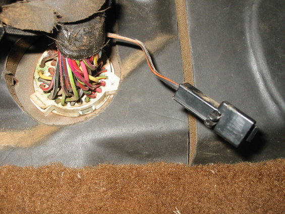

RABS Self Test Diagnostic Connector Location pic in an 88; "...it is next to the brake pedal which this is a picture of and is C111; It has the one wire that is black/orange.."
Source: by Jem270 @
http://www.supermotors.net/getfile/552076/fullsize/rabs-test-connector-for-1988.jpg
