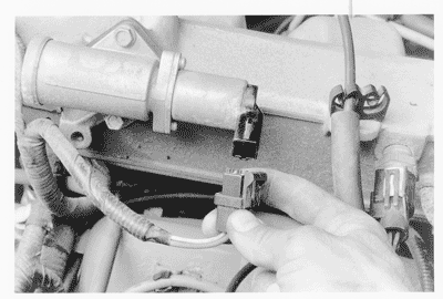

Removal & Installation
1.To remove the IAC valve, first disconnect the negative battery cable, then the IAC wire harness plug

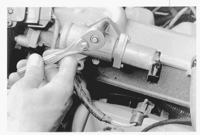

Next, remove the two IAC valve attaching bolts ...
... and pull the valve from the intake manifold
2.Disengage the wiring harness connector from the IAC valve.
3.Remove the two retaining screws, then remove the IAC valve and discard the old gasket.

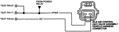

& more testing;
TESTING
1.Turn the ignition switch to the OFF position.
2.Disengage the wiring harness connector from the IAC valve .
3.Using an ohmmeter, measure the resistance between the terminals of the valve.
Due to the diode in the solenoid, place th89684g36.gife ohmmeter positive lead on the VPWR terminal and the negative lead on the ISC terminal.
4.If the resistance is not 7-13 ohms, replace the IAC valve.
