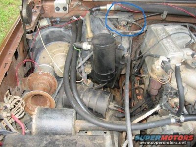

MAP is on passsenger side firewall, high; here is one circled in blue by Jem (88 Bronco, but should be in same area)
