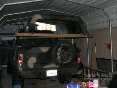

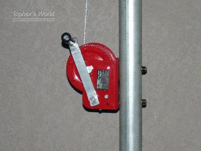

In the efforts to remove the tops has anybody ever used something like a duct lift? kinda like a manual operated forklift of sorts. Or this;I have been toying with this idea I have to build a lifting device that would be suspended from the top of my shop (12-14 feet) by a cable through a pulley maybe two and down to a boat winch. The piece that would actually lift the top looking like a "C" with a loop on top for a cable and a cross bar on bottom padded to support the cap on the inside. Typically I have no one to help with heavy lifting such as this so I have to figure out a way to do it by my self. My thinking is this would lift it and store it out of the way so as to prevent dammage.
yo Elmo!
YEP!
here ya go pal;
Lift, one man in a 90
Source: by 90Beater (Topher, Chris) at http://bronco.tophersworld.com/writeup_top_lift.htm
& Mark did sommething similar,
http://www.icehouse.net/mchristy/topper1.jpg
Lift, one man
Source: by Mark C at http://www.icehouse.net/mchristy/remtop.html
