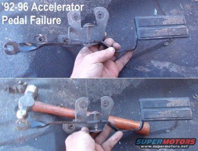

Thank you, how about the connection at the gas pedal? That plastic tube or sleeve that has the spring is what's binding up on mine. I don't know if I have to replace the full cable? Or can I just replace the link where it mounts from throttle body?
I'd replace the entire cable; its about $20.00 from our sponsor here; Jeff's or NAPA, etc.
http://broncograveyard.com/bronco/i-30792C-froogle.htm
FYI;
Accelerator Pedal Failure in 92-96; "...The pedal arm is simply pressed onto the splines of the shaft, and it can slide sideways, becoming loose & noisy. To fix it, lay the pedal arm across the jaws of a vise with the pedal mounting bracket free between the jaws. Then hammer the pivot shaft down thru the pedal arm like a nail thru a board. If the pedal is still loose, use a blunt drift to damage the splines, then drive the pedal onto the damaged area, & damage the splines on the other side to lock it in..." Source: by Steve83 (Steve, That dirty old truck) at SuperMotors.net
ok? have to roll now; will be back Sunday or Monday
I don't think the cable can be taken apart; the plastic sleeve/tube prevents moisture from creeping into the inners and freezing in cold weather; and keeps crud out internally.
