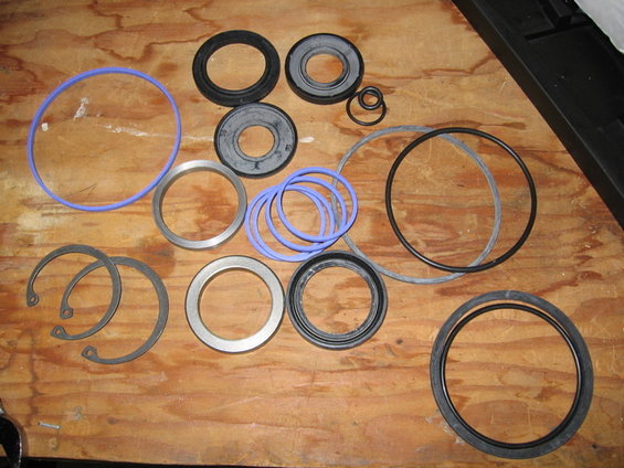

Bigric used this Ford MotorCraft Shaft Seal Kit (input shaft seal kit Ford F3AZ-3E502-A; sector shaft seal kit Ford D7AZ-3E501- B)
http://www.supermotors.net/vehicles/registry/4584/27329
and his full rebuild @ http://www.fullsizebronco.com/forum/showthread.php?t=46322
See if that NAPA kit is = to the Ford kit
& Chexmix used this kit in his 89 Bronco;
http://www.supermotors.net/getfile/464962/...ze/img_0601.jpg
... he wrote, " from AutoZone...PowerCraft brand I think..."
