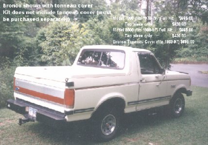

IS Out-of-Business; www.creproonline.com) sold the mold to Jeffs Bronco Graveyard; a Jeff's rep. told me that the Bronco fiberglass half-cab conversions w/ glass slider mold was in poor condition upon arrival; he said it should be available Summer 06,
but ....
Here it was;
Fiberglass Half Cab Conversion w/Glass Slider original description
Source: by Creative Products
http://web.archive.org/web/20011020014444/..._conversion.htm
