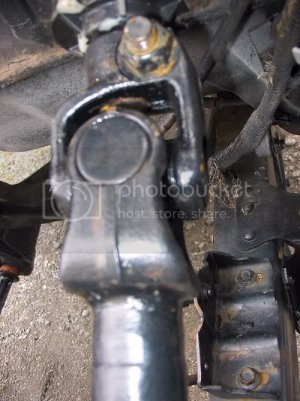

I've always liked body lifts. Since I swapped in an F800 steering joint with a grease fitting, wear shouldnt be an issue, either.
