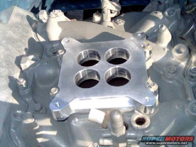

well, it's a choice. A carb is certainly easiest to setup but fuel injection will give you more hp/torque and better mileage & drivability. The downside is of course that it's more expensive, complex to install & troubleshoot, particularly a factory system. If you have ALL of the supporting hardware (wiring harness, control module, high & low pressure fuel pumps, etc) then you certainly *can* retrofit the factory EFI onto what you're building. I suspect there's probably someone out there with a kit allowing you to run the factory hardware without all that but I haven't looked into it yet. I'm starting on another 460 swap of my own but I'm planning to run with a throttle body EFI rather than the stock multiport.
If all you have is the factory hardware then I'd look into what's available for stand-alone setups, otherwise you'll have to find a matching harness & PCM to make it run.
Personally, it's a lot of work but worth it if you can run a Mass Air EFI (I wouldn't bother with a Speed Density system unless the engine was pretty much stock or very lightly modified) the the benefits will be well worth the effort.
