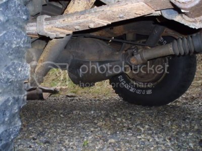

see attached pics...
if i am looking at my leaf springs right, then i have 7 leaves. is this stock?

looks like someone added a helper setup which is odd because you wouldnt be hauling a heavy load.
here is what the stock rear end(8.8) looks like in my 85.

No you have an add-on helper spring set-up. The main leaf pack on the bottom has four leafs, the other 3, separate ones on top are the add-on. The add-on doesn't necessarily increase your ride height, more for carrying heavy loads and keeping the rear springs from sagging. This also makes the ride very stiff as compared to stock. As I mentioned, measure the height of the front coil springs, then report back. 12" is stock, JSM84
