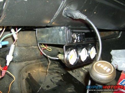

I didn't want to cut the dash or support for the radio so I made a custom mount for my new head unit
Posted Image
http://www.supermoto...ze/hpim0463.jpg
