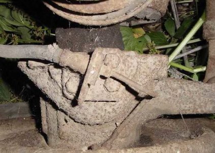

Should be a Dana 30 axle. Ford didn't start putting D44s under EBs until 71. The 30 is more rounded than the 44 is. The Dana 44 looks like the attached picture...
