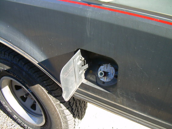

whats up with the second fuel door? two tanks?
84' bronco 2: high output alternator, 3" skyjacker sus. lift, optima battery, new crate motor.
#7 User is offline   jtg
  • Duck Tape L'fixer :)
  • PipPip
  • View gallery
  • Group: Members
  • Posts: 18
  • Joined: 30-March 08
  • Gender:Male
  • Location:San Carlos ca.
  • Interests:Boats and Broncos
Posted 11 April 2009 - 01:03 PM
It's not a second fuel tank, but that would be nice if it was.
I raised the fuel tank up, so now it's mounted on top of the the frame. I had to move the filler neck up too because the tank sits about 9 1/2 inches above the floor in the bed. I used a recessed gas cap housing from an old truck with an uttility bed. I have an air fitting for the on board air stystem (still under construction) behind the door were the old gas cap was.
I used this build thread and simplified it a little.
http://fullsizebronc...ight=tank+raise
You have to read the hole thing because he is figuring it out as he goes.
