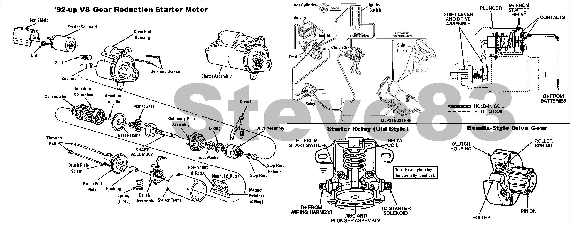

See our pal Seabronc's schematic, #3
here it is;
and by steve
http://www.supermotors.net/getfile/285644/...terexploded.jpg
see the image and diagram that states Starter Relay (Old Style)?... ck your's w/a test light or meter; if ok, ck ign sw if you had this problem prior to blowing da relay up
also; this happens a lot; did you jump it?

I'm having the exact same problem with my 1987 Bronco, and have narrowed it down to the little ignition wire that energizes the solenoid (red/light blue stripe). If you bridge the battery-side of the solenoid with the little energizer pin, the starter spins - but most importantly, the solenoid doesn't stick anymore. If you replace the red/light blue cable and start it with the key, then it sticks.
Attached is a copy of SeaBronc's diagram (thanks btw!) with the faulty wire highlighted in red. Circled in blue is a junction (C121) which connects it with the ignition module. Somehow when this wire is energized, it makes the solenoid stick, but when the same pin on the solenoid is energized from the battery, it is fine.
Any ideas?
