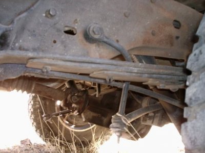

This is what rocks can do to your rear sway bars...
That was with stock suspension. When I put may 6" lift on, I did not re-install either swaybar and have not noticed a drop in performance. I have also been towing around big U-haul trailer the last few days with no problems. I did keep both bars though. If I start to notice problems in the future, (as my brand new springs and shocks age) I will re-install the front one first and see how it goes. If it still needs some more help, I might put the rear one back on also. But since I have no problems yet, I'm thinking they will probably never go back on.
