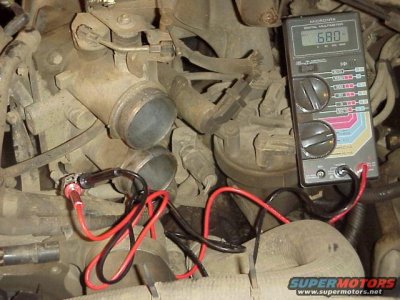

Location; Throttle body
Posted Image
by pepe
Throttle Position Sensor (TPS) Test in a 92 (loosen the 2 Phillips screws until voltage is less than 1.0 volts @ idle (.97 volts) Source: Bigric
