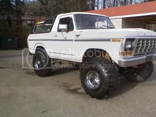

Heres a pic of mine with a 6" suspention lift and 3" body lift, 44" tires with no trim to the fenders.No rubbing on the fenders,but it does rub the shocks at full turn.
So your 9" is already installed correct??? If so, did you have to changed or adjust the drive shaft?

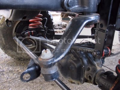

With the 9" lift, did you flip the tie rods on the knuckle? Are you using the factory tracbar? Did you raise the attaching point on the axle or use a drop bracket for it?
On my 6" skyjacker kit, with a 3" drop pitman, I made a 4" drop bracket for the tracbar, and it's pretty close to parallel with the draglink.

Posted 19 May 2009 - 06:27 AM
Attached ImageI have a 9 inch suspension and a 3 inch body lift,The truck was on 44s for about 10 years before Jerseys new lift laws,Anyway my tires only would just touch the front bottom of the wheel well on the front fenders only when I had the wheels completly turned and backing up,,,Just nipping them,no damage or anything.Besides that I had no other issues.This picture is currently with the 40 inch ground hawgs though..
1978 bronco
351 M
Headers
Dual 3 inch exhaust
C6 Trans
Eledbrock intake
600 holley
DUI distributor
9 inch suspension lift
3 inch body lift
Dana 60 rear
Trac loc in rear
44 frt 8 lug
4.56 gears
40 inch Ground hawgs
8000lb warn winch
Road armor bumper
Kayline soft top
Factory roll bar
http://www.mudspace.com/muddrivermike
