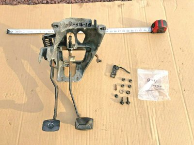

Shaw,could you post a picture of it and maybe someone will have a spare or solution to fix it with a better idea?

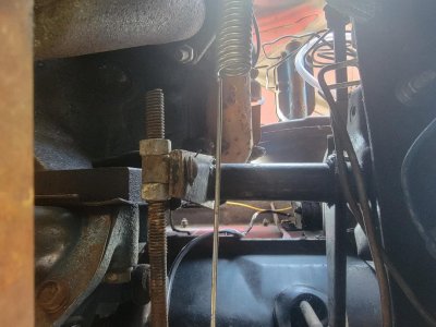

The clutch spring will be UNDER-NEITH the bronco. Locate the clutch fork coming out of the hogshead and you,ll see it. The hogshead--is the same as bell houseusing. Hope you have a garage to work in. I know its cold in Montana. Hope you doing doing better.

Underthe truck--looking up at the spring wire
