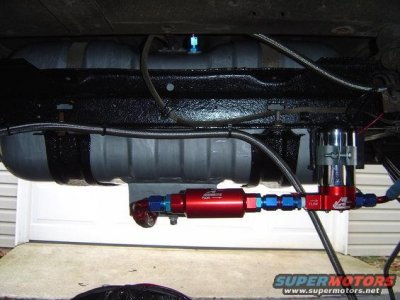

Looks clean, dude!!! Can you give more details on the fuel system parts, like brand and specs? I'm putting stuff together for my 460 using a fuel cell. JSM84

I used the stock tank but I had a sump welded in it. The pump is an Aeromotive,it's the Street strip pump(part# AEI-11203),not the H/O pump.This pump has to have an external regulator because it will flow 18psi pf fuel.The fuel system is all Aeroquip,I have a -10 (5/8") line going from the tank to the pump with a 100 micron filter before the pump. I have a -8 (1/2") line going from the pump to the rugulator, with a 10 micron filter after the pump. At the regulator I'm running a -8 return line back to the tank, and a -6 (3/8") line going to the carb. I could of used a pump that was already internally regulated but I wanted a return style instead. With a return style, the pump will run cooler and you will alway's have a cool supply of fuel coming from the tank. Since the unused fuel will go back to the tank. The system I have will support 700 horse no problem,it's a bit over **** but when I add nitrous the fuel system is already set up for it. The electric pump's are a pusher pump's, not a puller like a stock mechanical pump. Your going to want and install it as close to the fuel cell as posible.Like I mentioned earlier I used Aeroquip fitting's and hoses on everything because I wanted the professional look. It's definetly expensive.Between all the component's I have in the fuel system I probably have close to 800 buck's invested. Any question's you have I will be more than happy to answere them for you.

The only thing with that setup that you have in the picture is that it looks like it all hangs really low, any issues with that?

No,with the 9 inch lift and 38" inch tire's it's not to low.That's why I had the sump put in the tank facing the rear axle so I could have the pump and everything better protected.
I thought the same thing about the pump hanging down, but then noticed the top of the rear axle. That's got tons of room, and looks fine.

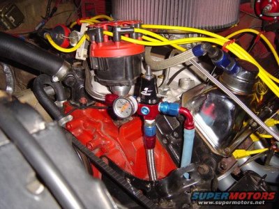

There is a difference in regulator's. The return Regulators have a port specific for the return system. It just hold's back the pressure to keep the fuel PSI at what you set it at and the rest goes back to the tank. Your going to want to get a bypass style regulator which is a return style, a regular one will not work.
I have a 4 port bypass regulator on mine, you can use a 2 port though. When hooking it up the supply line from the tank will go into one of the side port's and the return to the tank will go from the bottom port. On mine the blue line in the side is the supply line from the tank and the braided line at the bottom is the return.
